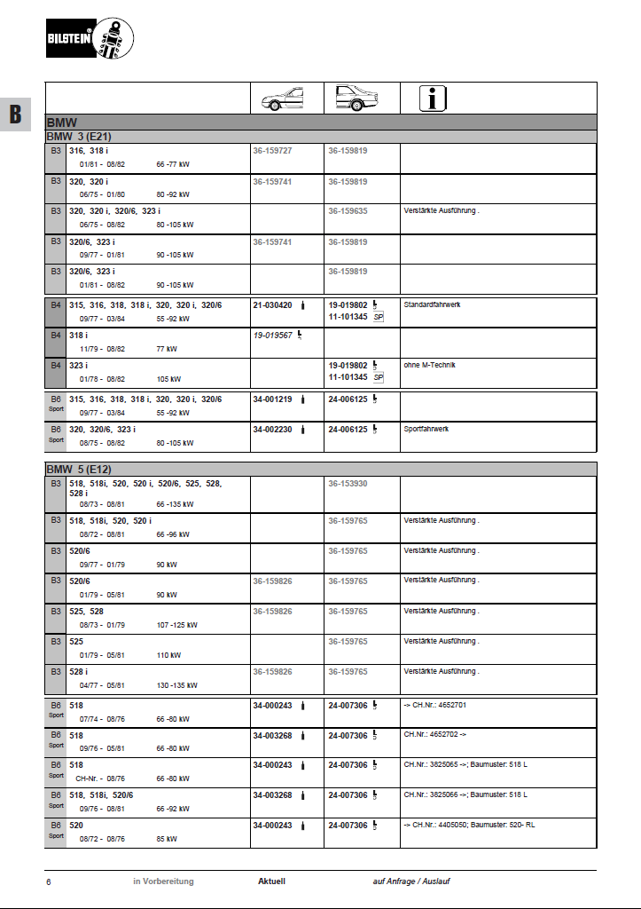

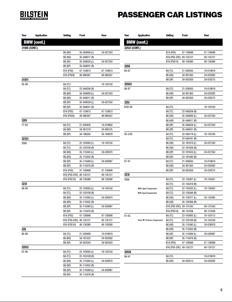

Referencias del catalogo Bilstein US

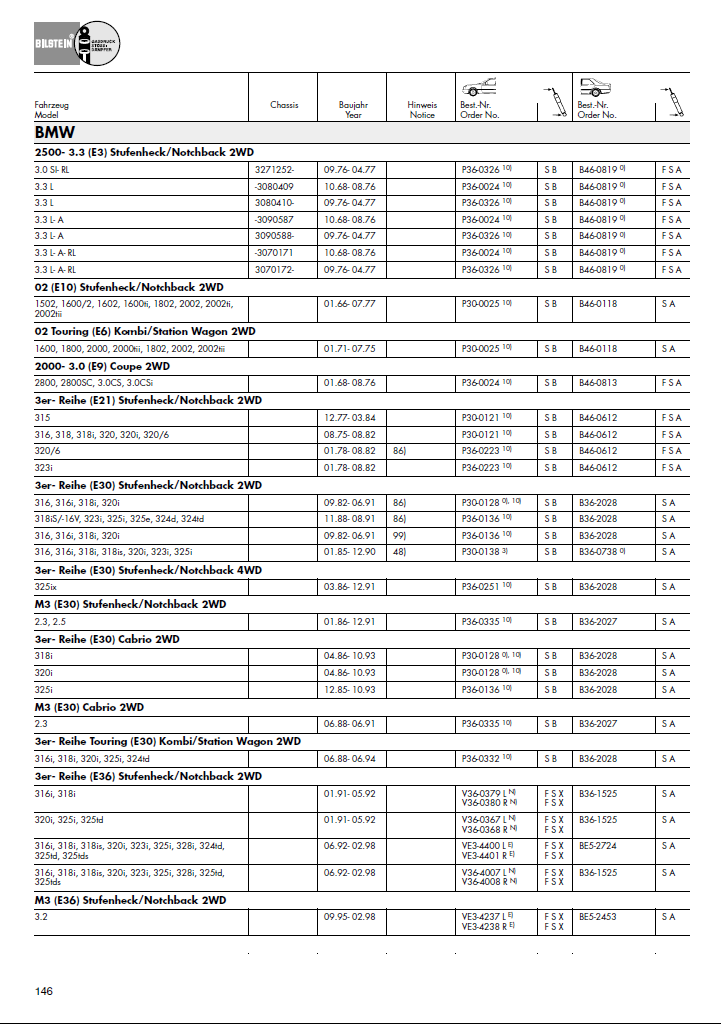

Referencias Bilstein antiguas

Las aplicaciones están así:
Chasis: BMW E21 315, 316, 318, 320/4, 320i, 320/6 Eje delantero Eje trasero
Tipo Ref. nueva Ref. antigua Ref. nueva Ref. antigua
B4 21-030420 F4-PNE-3042-BE 19-019802 F4-BNE-1980-BE
B6 34-001219 F4-P30-0121-H1 24-006125 F4-B46-0612-H0
B8 34-186350 F4-P30-0125-H2 24-184618 F4-B46-0617-H0
B8 34-183554 F4-P30-0125-H1
Chasis: BMW E21 320/6,323i Eje delantero Eje trasero
B4 F4-PNE-3035-BE 19-019802 F4-BNE-1980-BE
B6 34-002230 F4-P36-0223-H0 24-006125 F4-B46-0612-H0
B8 24-184618 F4-B46-0617-H0

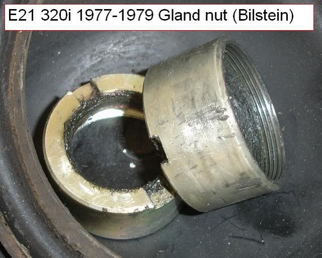

The early/late model e21 320i 4cyl model share the same front strut inserts, only the gland nut is different. The e21 323i uses a different setup altogether. Since Bilstein no longer makes Front Sport Strut inserts for the E21 323i, and if you want to use the E21 320i Bilstein Sport inserts on the 323i strut housing, then you would need the following gland nut from Bilstein--Bilstein P/N: B4-B30-U232A1.
The 323i front strut housing has a 36mm piston diameter. The 320i strut insert has a 30mm piston diameter. So, you need a male gland nut that has an inner diameter of 30 mm and a outer diameter of 36mm.
320i 45mm strut od, uses a 38mm insert (shock) which has a piston size 30mm
323 51mm strut, uses a 45mm insert, and has piston size of 36mm.

Gland nuts M45 x 1.5 (Secures the sturt insert inside the strut housing).
Early (77-79)
31321115398 (BOGE)
31321130068 (BILSTEIN) <--- Has a different Bilstein part #
Late (80-83)
31321123901 (BOGE)
31321126275 (BILSTEIN) <--- Has a different Bilstein part #
Part # for a post-80s bilstein gland nut is B30-629 F1
