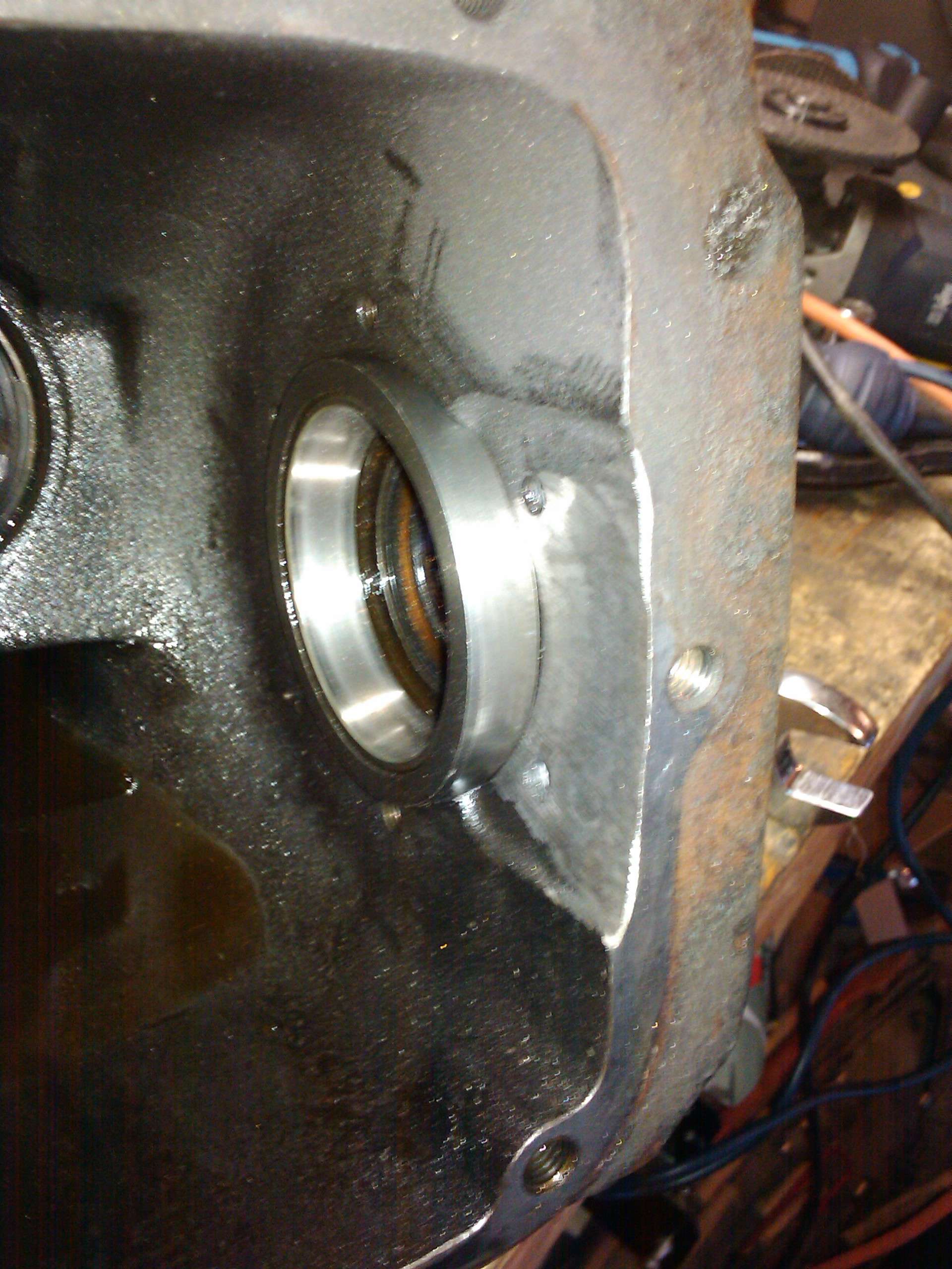

The opening on the e21 diff (right) is smaller than the e36. On the e36, the lsd/ring gear unit can be inserted straight in. With the e21 case, the unit must be inserted non ring gear side first, then rotated. A small amount of the case needed to be removed to allow the ring gear to clear.
I started by grinding away at the already recessed portion in these pictures. This is on the ring gear side of the diff. The ring gear just wouldn't clear this part. I ended up removing almost 1/8" of material, a little bit at a time, until I had enough clearance.
I was concerned that the large o-ring on the side cover wouldn't make a good enough seal with this amount of material removed, but I test fitted the side cover, and it seems to be fine.
LSD unit with ring gear installed with both side covers on.
NOTE: side covers must be from a non-lsd e21 diff. The LSD side covers are wider, and will not work.

Lastly was the rear cover gasket and rear cover. With those in place I had a complete, tough, limited-slip diff ready to be installed and broken in.
That's all for right now, I will be editing all this over the next couple days.
