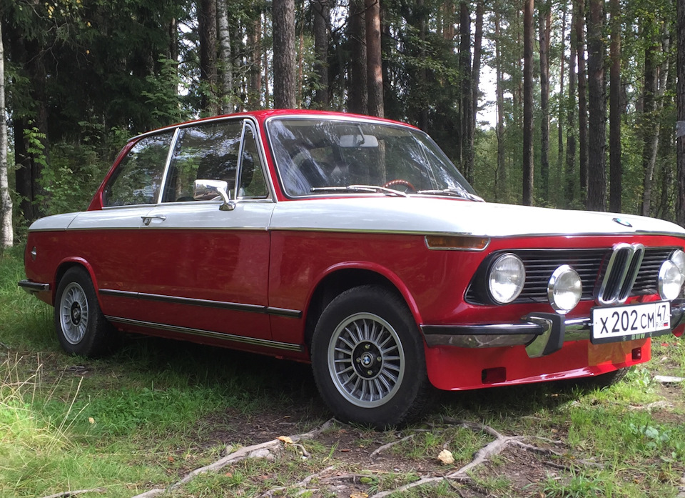

Hello!
My name is Mikhaylov Alexey, I from St. Petersburg.
I show in this blog my BMW 2002, made in Germany in 1974 and restored in Russia in 2016!
In the course of restoration original details of BMW 02 series have been used. New and second-hand spare parts were bought on eBay and in other shops worldwide.

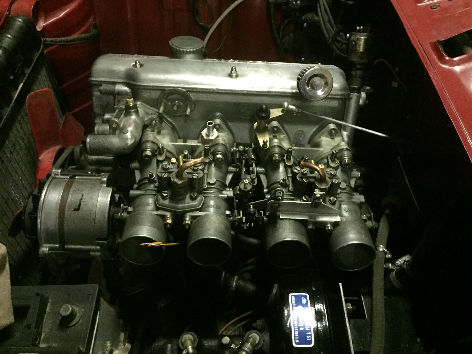

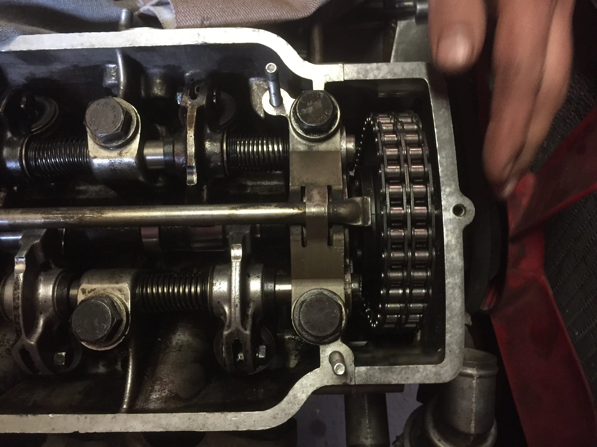

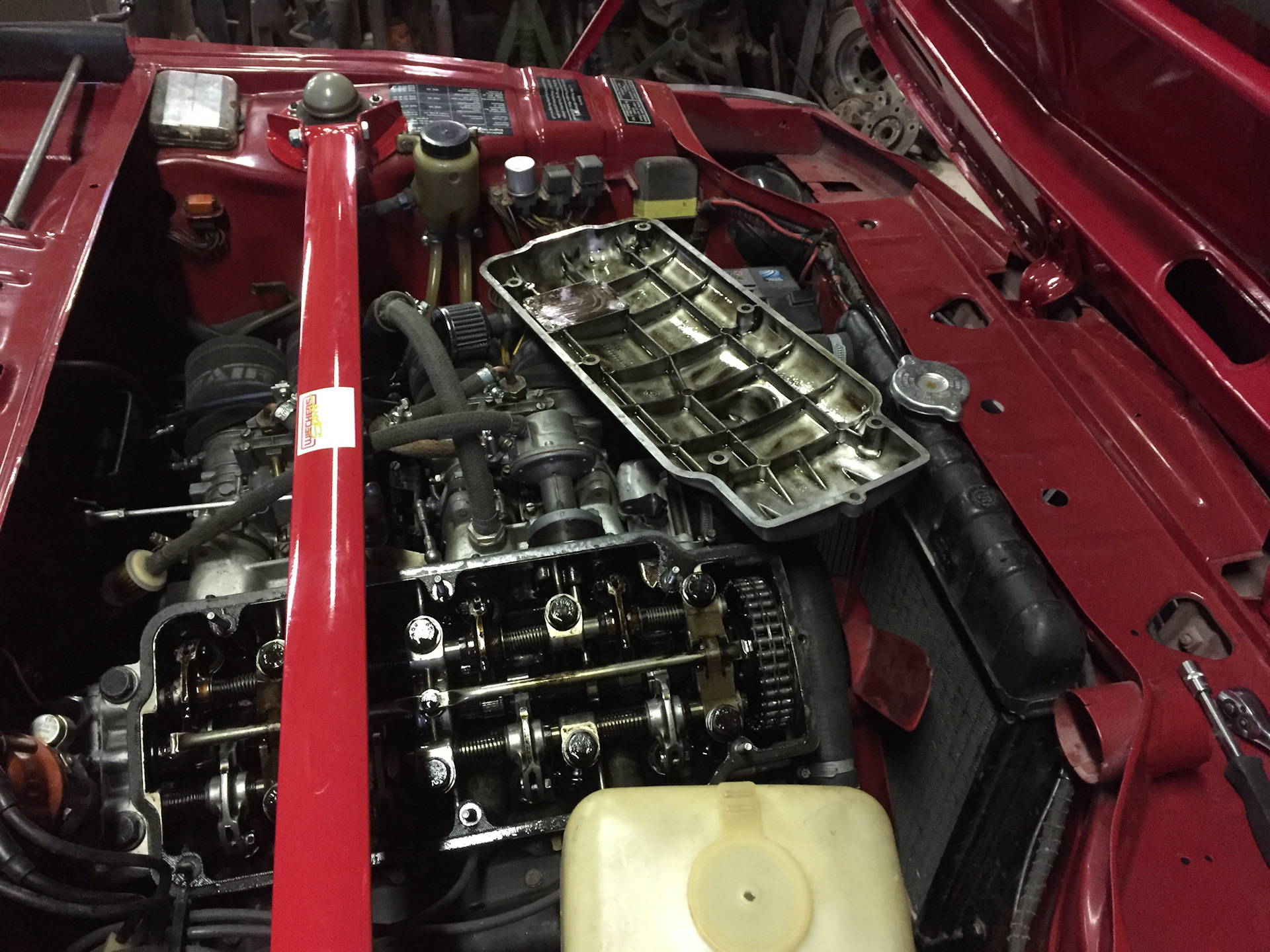

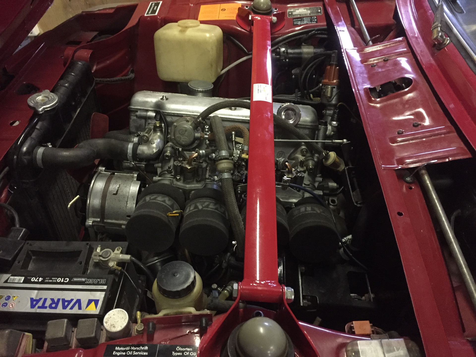

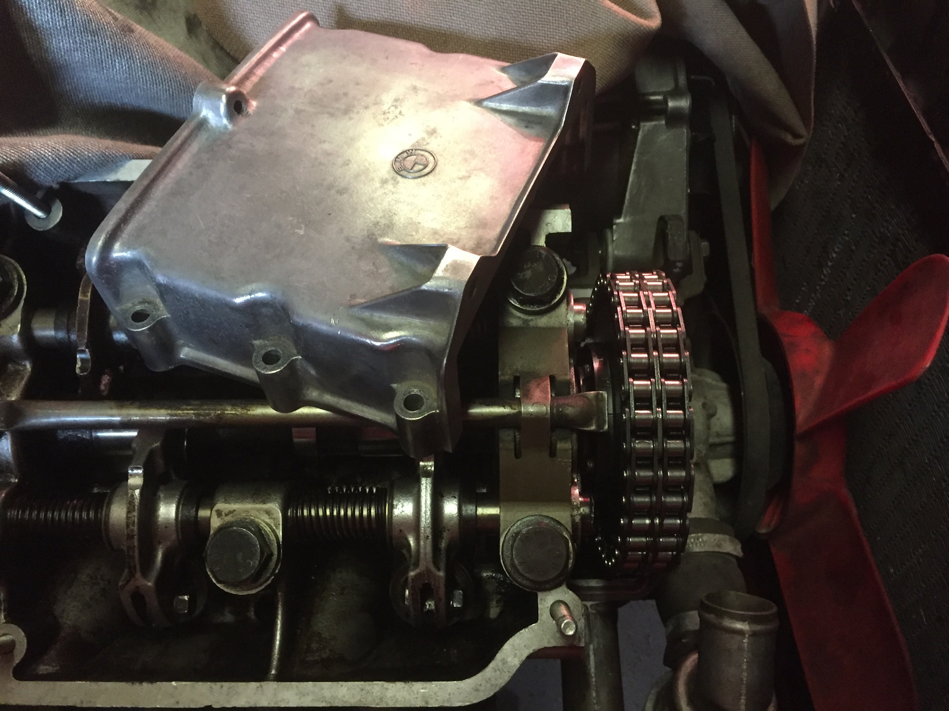

I continue the story
Rebuild cylinder head BMW M10
A cam-shaft from Elgincams under extent of compression 9,5
Head of the block of cylinders from e21 320 with the carburetor under extent of compression 8,1.
Therefore it is milled from a head - 2,5 mm. Also new the valves, a chain, axes of rockers, etc.
